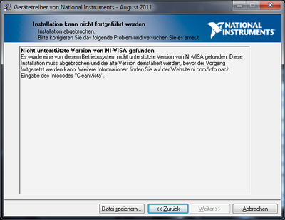

Being in "installation mode" now, I probably made a fatal decision. I tried to upgrade VISA divers to Version 14.0.1. But the installation failed:
So the next thing I did was to uninstall VISA drivers and everything that has the term 'VISA' in it's name.
Next attempt to install VISA drivers: same result (unsupported version found).

Then I re-installed it from DVD. This went well until I changed the DVD to install the Labview drivers. The installation procedure stopped with same warning:

I guess the "nierInterface.dll" is part of the driver installation but this doesn't work anymore. Neither for the original driver DVD, nor for Version 5.1.1 nor for Version 14.0.1.
Meanwhile I'm out of further ideas, how to solve the problem. Why can't I install this VISA drivers?
