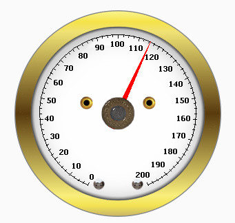

Is possible customize the Gauge Indicator?
Hi, I want to know if you can customize the Gauge indicators of Labview to look like this?

You can customize controls using the control editor. You can replace parts with graphics. Not sure how you'd do the larger tick marks, though. There is a section in the LabVIEW Help on customizing controls.
There are also some examples in the UI Interest Group community.
Check out the links for this tag.
The hardest part will be the needlt and the needle's shadow.
If those are important then you will have to use a picture control to render the needle and shadow over the static background.

I have made a similar Gauge, which looks like on the picture.
The problem is that I want to change the red arrow with a new one:
When I replace it with the editor, it does not rotate properly. It only moves the whole picture, but the arrow does not change the tilting angle. Can someone solve this problem and post the file with properly rotatable new arrow? The arrow and the control file are attached to this post.

You will have to wait for a future version of LV to be able to reaplce the needle and get it to rotate. If you search enough you will eventually find a post by Rolf Kalbermater who spoke of the the graphics format used, its source back in the early days of LV on the Mac blah blah blah. As I posted years ago, if you really need to replace the needle you will have to "roll-your-own" and render the image using a picture control.
Christain posted code that demonstrates how to ratate an image and display it in a picture (I think I tagged it). Throw in some mask details and it is do-able. Depending on the size and how often it needs to be udpated, it may not be too much of a CPU hit.

If you want a custom needle, this is ideal fodder for a 3D picture display. If you display it as a couple of textured quads in 3D (or a quad for the face and a piece of custom geometry for the needle) you effectively get 'real time' rotation for free with negligible CPU overhead.
I have some code to do '2D in 3D' (attached). It needs cleaning up but it gives you the basics. It's based on LV's 'solar system' example.
