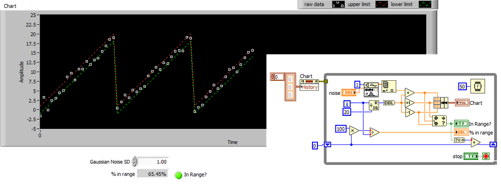

See if this simple simulation can give you some ideas.
Message 9 of 15
(1,615 Views)
Thank u very much.
Could u explain me, the block diagram.
And why I need Gaussian Noide SD?
