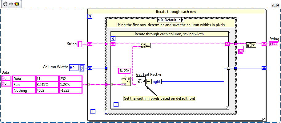

You can (and probably should) follow what RavensFan recommends, especially using a monospace font for your string indicator, such as Courier.
However, if you really want to use the default font, you can use "Get Text Rect.vi" to determine the size in pixels that your text will produce. You can then use the widths to determine how many spaces to add to subsequent text that are in each column.
Here's code that'll get you started. This snippet gets the column widths in pixels for the first row:
This snippet uses the column widths for subsequent rows to determine how many spaces to pad for each "cell" of your 2-D array:

Thanks for your kind reply.
Actually in my question on the first floor,you can see that I already pad every element to be the same length of 20,this way doesn't work as expected either.
