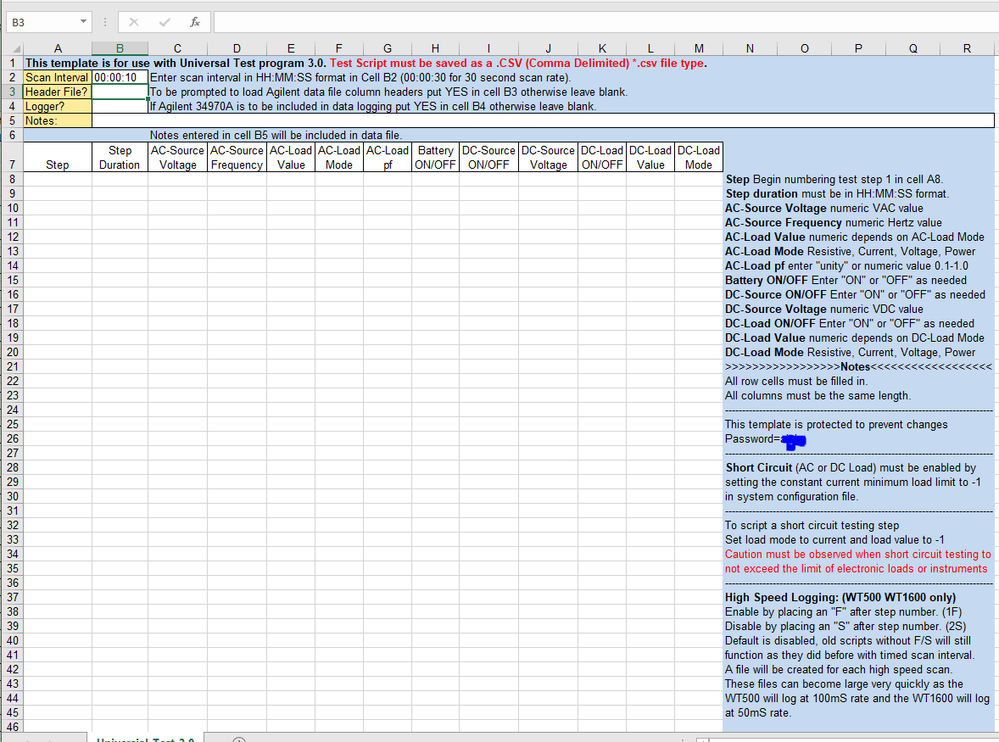

Well I really like using XML files for this but they can be hard to work with specially for end users that are not technical minded.
The simplest way I have come up with is create a DETAILED template in Excel that instructs the user to save the file as a .CSV, like this:
Then using the "Read Delimited Spreadsheet" vi I read that file and pull out the values for my program.

In the past, I used a configuration file to read all of the channels and their settings and then used the DAQmx Create Virtual Channel to add each channel to the task.  If I were to redo it now, I would use JSON or XML.  There are plenty of libraries for each.

BTW: Here is how I read the CSV "test script" file and parse it to load the values into my "Test Cluster"...
