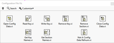

Hello
you can't create a cluster from a text file. Or you need scripting.
But you can manually create a cluster, and the manually set every value.
You can read INI file with Labview VIs "Configuration":
And this example :
  • labview\examples\File IO\Configuration (INI)\Configuration (INI) File.lvproj
