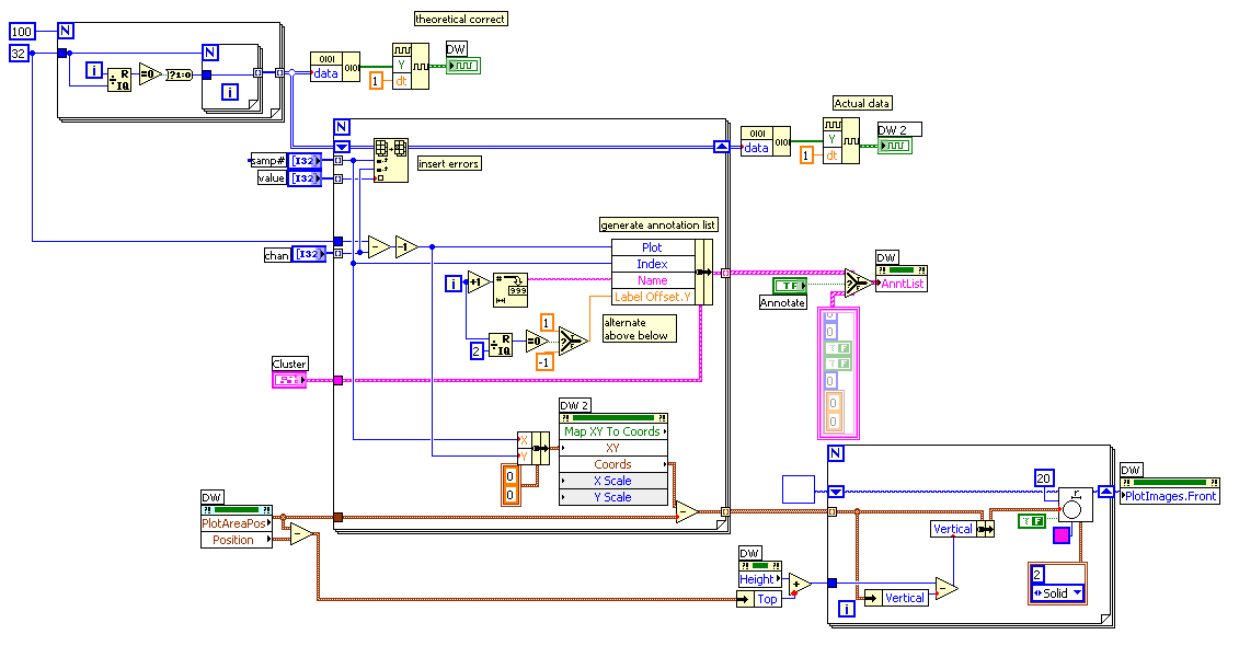

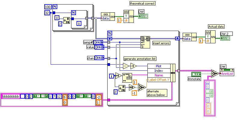

Actually uncle's suggestion is not that bad!
Put the theoretical correct on top with a transparent background.
Put the actual data in the background graph with a contrasting color.
This will illustrates the bad states but may be hard to find if the graph is busy. Annotations can help direct attention to failing states.
The code looks like this.

Note:
Annotations were not available in LV 7.1 I believe.
Cursors can be used similarly but require a bit more code to do what the annotations do better. Smiley Wink

LV8 also added the ability to control imbedded images. The same effect could be accomplished in LV 7.1 but a seperate picture control was required for that.

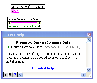

I'll give out bonus points (Stars) for anyone that can produce a demo that show me how to use the "Darken Compare..." property node.
The help and name sure sounds like something I want to know about. Smiley Wink

Surely I ll update here. Smiley Happy
But is this prpperty available in 7.1 ? Smiley Indifferent
Moreover, the Digital Graph I use is NOT of this datatype of a bool cluster.It is of the Digital array type. Smiley Wink

No its not in LV 7.1.
I found it in LV 8.2.1 and am not usre about LV 8.0.
Naturally, I can't give a demo, but it seems to me that you can't get much simpler than a boolean input. Smiley Very Happy
My guess would be that if you wire T it would highlight (or darken, as the help says) the T sections of the graph and vice versa for F. Does it not do that?

Always on me to be precise in my questions. Smiley Mad
OK I admit I was lazy and used the plot position property which is private. Smiley Surprised
The "Darken..." is not private (not blue) but I could not see any difference on my graphs when I set the property true.
Not knowing what that property does I was hoping I could use that to highlight differences between a "good and bad" signal. But I have no justification for that idea.
