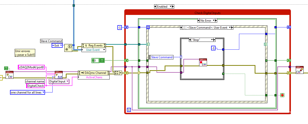

Hi to everybody, I hope anybody can help me with the next case:
I am working on a system in which I have to read signals of 5 different sensors which have different ways to communicate (4 - 20 mA, voltage, RS-232, ModBUS, etc.) with the DAQ Device (cDAQ in my case), at same time when I am reading the variables I must check for the state of several digital inputs to verify connections and if any is interrupt I must stop the Data Acquisition.
My question is if is recommendable to put all the tasks in a single loop with the logic shown in the attached image.
Or if I should divide the tasks in a multiple loop architecture.
If the answer is the second, my next question is: How many DAQ tasks per loop is OK?, my doubt is based on the number of variables that I am going to read
and the different ways to get the measures, specially which are by protocols (ModBUS, RS-232), all this by the response time.
Thanks in advance, all suggestions are welcome!

Hi AYanez,
while you could put all "tasks" into just one loop I would recommend to separate them in several parallel loops. I would create 3 loops: DAQmx, RS232, and MODBUS…
That way you can easily handle all those different samplerates and response times!

RS-232 and Modbus should definately be in separate loops.  For the DAQmx, it really depends on how often you need to read each task.  I prefer having a separate loop for each type of taks (analog input, digital I/O, counter input, etc).

I would recommend using a loop just for control and UI events.  It should only have an event structure.  Don't use the timeout case, since that just turns the system into a polling.  Use Queues to send data from the controller loop to your other loops and User Events to send data back to the controller looop.

I understand your point crossrulz, but I was referring to use an Event Structure with the next approach:
My approach consists in delegate a DAQ Task to an Event Structure, which is normally sleep and with an User Event I could configure some actions like:
Start DAQ Task, Stop DAQ Task or Read values with the help of Timeout Event which will activate the polling in the loop when I send the Enum Item Read.
I see 2 advantages with this idea:
The loop has delay itself with the Timeout Event.
The loop does not waste CPU while we dont need of this.
I know that Queues are useful but my doubt is if this way of using Event Structure is OK even when it is not so common, if is not I appreciate if someone tell me his opinion about which would be the best way to separate the DAQ Tasks in several loops.

User Events to queue up DAQ tasks?  That certainly sounds like a Queue to me.  And the queue has a timeout if you want to use it.  Using a queue is a little more straight forward and easier to read, IMHO.
