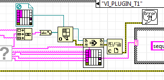

HELP! vi reference type does not match VI connector pane. THANKS
 (1) I got 3rd party vi.
(2) When I run it individual, it is fine.
(3) after build into test sequence.
it stop due to "not match vi connector"
Thanks for help
see attached file.

The connector pane (inputs and outputs of the VI) of FT_Set_Bit_F3.vi are not as expected.
Without the VI that actually loads the test, it's impossible for us to tell what is wrong with the connector pane. You could also post another test VI that is working. Then we could point out the difference(s) in the connector panes.
If I had to guess, the error out is there but is not wired to the connector pane... But that is just a wild guess.

Unfortunately, none of these VI's actually show how the VI is loaded (assuming all 4 uploads are the same).
It seems the error is generated somewhere inside a custom test sequencer. All tests have different connector panes. It's impossible to tell why this one VI fails based on the information you are giving.
I assume you can't ask the person who made the framework?

Look at the error message.  It tells you that the error is occurring in "SeqUUTCmd.vi".  No one can help you resolve the error because you haven't provided the VI that is throwing the error.

Accepted by topic author zy6
OK That helps us help you
To "Be a Test" within that framework the connector pane must match THIS pattern
All the inputs and outputs must be of the same type as that pattern
they must have the same options set (Required / Recommended / Optional)
And the connector pane cannot be flipped either horizontally or vertically nor rotated at all.
"Should be" isn't "Is" -Jay
