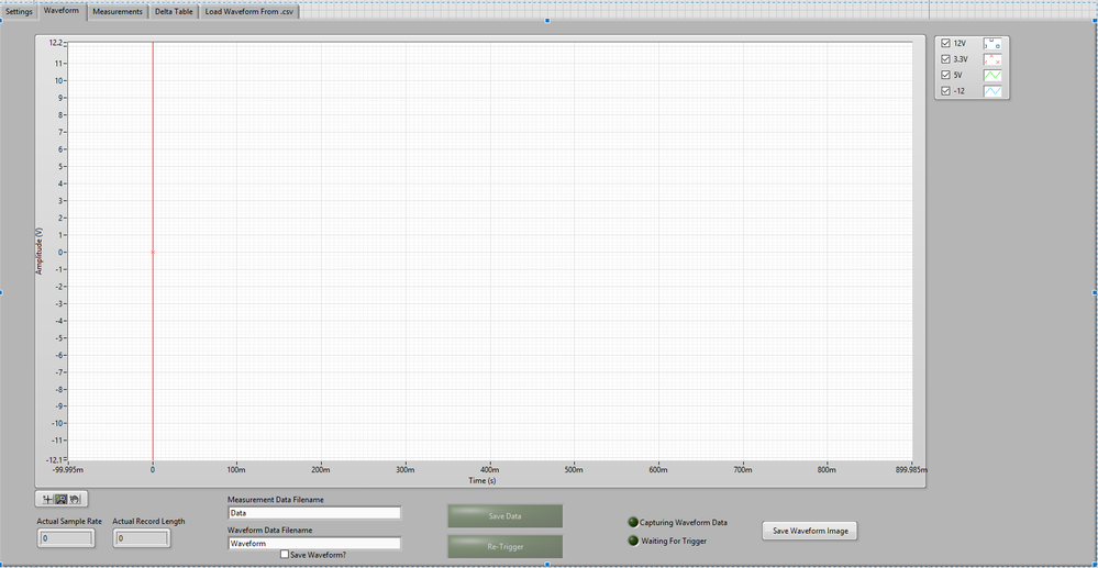

This is a small snippet I created from a much larger program. The problem I'm having is when I switch between tabs and the tab I'm switching to has a large dataset, there is a few second delay before the tab switches. I didn't find much info from my searches, so I was hoping somebody that knows what's going on can provide more information. If that's just the nature of LabView, then that's fine, but if there's an optimization, I'd like to be able to implement it.

You are trying to plot millions of points on plot that is probably at most only 1000 or so pixels wide.
Look at this or this for inspiration.

You graph is severly taxing the UI thread. There is a nonzero cost graphing so much data:
3M x 24 x 8bytes/point is almost 600MB!!
It is not reasonable to graph that much data! Given that your graph only has about 400k pixels, it seem silly to graph 72M points on 0.4M pixels, right. Can't you decimate your data somehow?

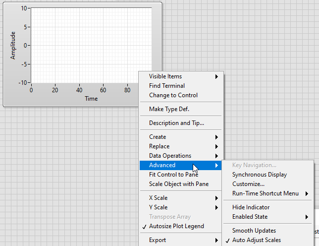

PS Turn Anti-aliasing and smooth updates off, should increase speed somewhat, but that is not your rate limiting step.

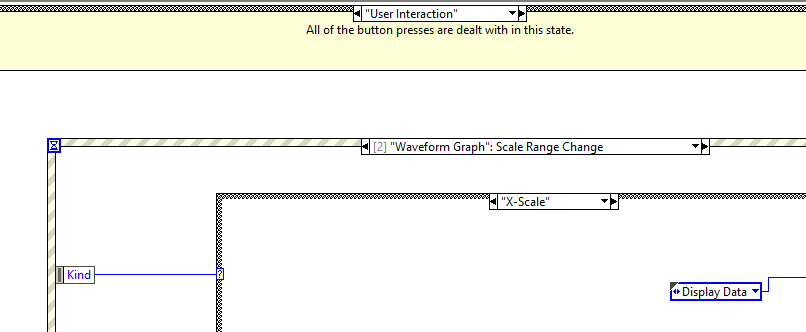

I had first taken the idea of decimation to mean to modify the original set of data, but now this makes a lot more sense when thinking about creating a whole new set of data based on the original. I'm imagining something like an event based on clicking on the plot, checking to see if the dimensions have changed, and then performing the decimation based on some ratio of the waveform interval and the time axis.
Good thought. That is exactly what I do. Note that you only need to change the decimation and display when the "x-axis" changes, no need to re-decimate if ONLY the y-axis changes.There is a "Scale Range" Change event for plots that you can use. The event will give the min and max of the range. You can use that to find the indices of the data array that you need to decimate.

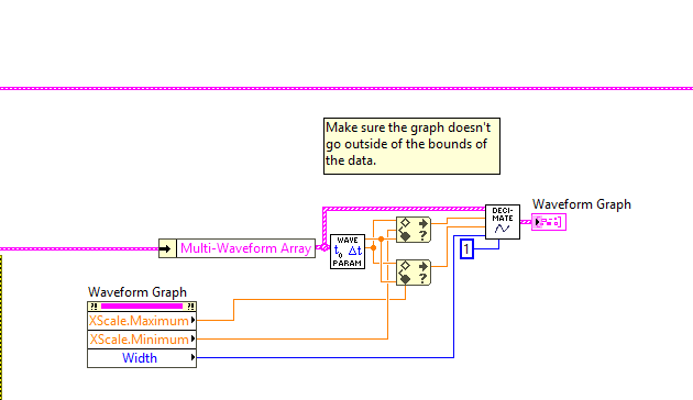

I wanted to share my solution, hoping that it may help somebody down the road. Decimation is a simple concept, but implemenation is a whole other story.
