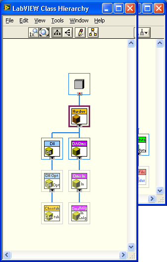

I neede to acquire from a NI USB DAQ widget. So I needed a new hierachy for Hardware. But alost all of my DAQ apps require some type of configuration that is specific the the widget. So I started the Hardware Hierachy that supports Configuration files as well as being able to run in "Simulate" mode.
19375i07CB10A9A5961845
So the Hardware hierachy takes advantage of the Config Class functions from the File hierachy and it realizes all of that functionality.
Next I had to be able to interface with a Cheetah interface to talk to some SPI slaves. The Dll branch was cloned from the "DAQmx" class and simliarly with its childeren.
So I hope the personal experience with LVOOP helps convince others that
"The more I LVOOP, the more powerful my library becomes and the less I have to code."
