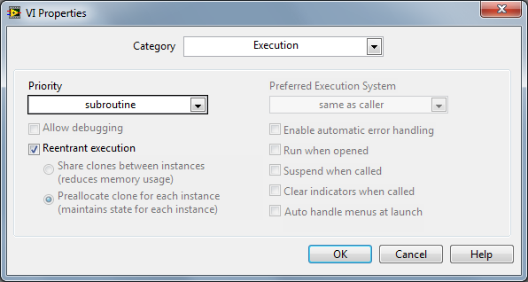

Today I'm going to talk about the subroutine priority setting on VIs:
According to the LabVIEW Help, "The Subroutine priority level permits a VI to run as efficiently as possible."  This is because a subroutine priority VI takes control of whatever thread is executing that VI, and does not release control until the VI is done executing.  For this reason, you cannot place nodes on a subroutine VI's diagram that might cause a wait to occur...you will get a broken run arrow on the subroutine VI if you try.
So when might you choose to set a VI to subroutine priority?   Typically it's for VIs that are doing a calculation, or perhaps searching a data set, and you want to make sure they execute as fast as possible.  Here's the diagram from one of my VIs that I have set to subroutine priority:
In this code, the "Item Array in" control might have thousands, or tens of thousands, of items.  To ensure this VI completes the search as fast as possible, I have set it to subroutine priority.  Also, I have enabled reentrant execution on this VI (note the checkbox in the first screenshot) since I use this subVI in multiple places in my code.  In fact, I can't really think of any reason why a subroutine priority VI should *not* be reentrant...if you have deemed a VI worthy of subroutine priority, it wouldn't make sense to have multiple instances of that VI in your code waiting on each other to finish execution.

Do multiple copies of a reentrant subroutine run in different threads?
I would assume that they have to, since they would be running in parallel, and subroutine VI instances have complete control over their own threads.  One way to double-check would be to use the Desktop Execution Trace Toolkit to monitor an app running multiple instances of a subroutine VI, and see if those instances get different thread IDs.

One caveat to mention: the subroutine priority does turn off debugging, so make sure your code is golden before setting the priority.

Subroutine priority also turns off a lot of the VI calling overhead.  This is because the compiler knows that the front panel does not need to be used at all.  It is nearly equivalent to inlining.  I have benchmarked a simple VI containing only a variant transform.  Turning on subroutine priority gave exactly the same performance as inlining the code (performance checked using the Windows performance counters).
