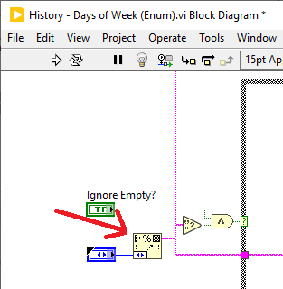

Now, the diagram of the custom probe VI comes up. Modify this diagram to accomodate your new custom probe type. In my case, all I needed to do was add a Format Into String to convert the enum to a string (since I started with the string history probe as a template):
I also hid a couple of controls on the panel of the probe that applied to strings, but not enums. And with that (hopefully under 60 seconds?), I've got a functional history probe for my enum!
