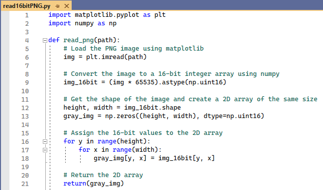

In the new era of AI and Python, it is easy to do things like this.  I looked up this very question here first, but no help.  I then asked for the python code from chatGPT, and voila, problem solved.  (In my LabVIEW 2019, I also updated the allowed version of python, to 3.10, but it works fine.)  Just passing along a useful tip for those still looking!
For those trying out @Rod.Loewen's code, LV2018 does not support numpy.ndarray as a return type (maybe newer versions do). You'll get following error:
Python returned the following error: <class 'SystemError'> g:\a\3\s\objects\listobject.c:189: bad argument to internal function site:forums.ni.com
I think that's what Rod is trying to achieve in the second part of his python code, but that just copies the first numpy.ndarray to a new numpy.ndarray.
Working and verified code:
import numpy as np
from matplotlib import pyplot as plt
def read_png(path: str):
    # Load the PNG image using matplotlib.
    img = plt.imread(path)
    # Convert the image to a 16-bit integer array using numpy.
    img_16bit = (img * 65535).astype(np.uint16)
    # LabVIEW (2018 at least) doesn't support np.ndarray.
    # Convert to list of lists.
    return img_16bit.tolist()
