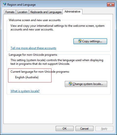

😎 Run Time Menu Corruption
I am going to post this here even tho it is happening for both Run Times.
I have no idea why but LabVIEW has somehow messed itself up.
However, on my LabVIEW install, the default Run Time Menus in a Executable are showing weird characters.
Custom menus seem fine.
LabVIEW IDE is fine.
English is set as the default language for the build.
I have tested this with a Project that I move to another PC and it build fine - so its not the Project/Build-Spec settings.
This is the Run Time of a Build Executable:
22567iFF620B5C1E444CD2
This is the splash screen of a build executable:
22565iAE5C0B0B4A04E0DA
I don't / or have not been playing with system settings either, but Mikael H asked me to look at this to help out:
22563iC7AC9DB2FA5E8D06
I have no idea why this is happening.
Rebooting did not fix the issue.
Maybe a reinstall of LabVIEW will?
Certified LabVIEW Architect * LabVIEW Champion
Message 8 of 20
(9,393 Views)

Hi jgcode,
Regarding the 'LabVIEW needs more memory' error... have you tried flipping the 3GB switch?
Also, the garbled text in the run-time environment... I've heard that repairing LabVIEW can resolve this.
I'll call this my 'fat penguin' post in the hopes that this helps 'break the ice.'
- Greg J
