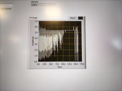

Hi
The image that I attached is what I get from measuring a constant DC voltage of 5.41.
Santhosh, I have to connect the AI- to the AIGND, right? And to the AI+?

connect both AI+ and AI- to AIGND

I did it and I get a value of -0.009 volts so I guess that the analog inputs are working
