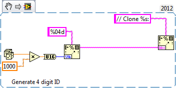

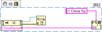

Alright, this is weird.
We ran the code on the stand this morning and everything ran asynchronously. The only thing I changed was the following:
Before:
Before, in each clone I was querying the clone name, simply to label when the clone did things in the IO trace log.
After:
Turns out when you use the single ref method with the ACBR node, the CloneName property doesn't work.
The CloneName property was returning a blank string. It does retun something valid under normal circumstances. Why it wasn't working for the earlier runs, I don't know.
So, instead, I used the following to label each clone in the IO trace log:
Once I switched to the "after" method, everything seemed to run asynchronously. Clones start up together, negotiate non-reentrant resources, and end at various times as expected.
It probably sounds crazy, but that's what I'm observing. Is it possible I inadvertantly did something else subtle that restored asynchronous behavior? Sure, but I don't know what it might be.
The symptoms to me look like I must have goofed and specified the wrong options flag, but I triple checked that flag, and didn't change it for the last run that ran properly.
This is likely one of those things... I'll never really know why it did what it did.
