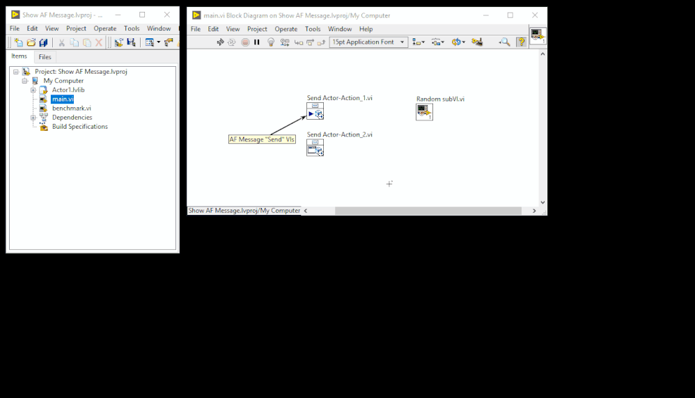

This plugin adds the option to quickly open the block diagram of the called VI from an Actor Framework Message's "Do.vi" by right-clicking on its respective "Send ... Msg".
To identify the clicked subVI as an AF's message "Send" VI, three checks are performed:
1) that the VI is part of a library that contains a "Do.vi" (so rules out abstract message classes)
2) that that library inherits from the AF's "Message" class
3) that it contains an AF Message's "Enqueue" .vi
These three checks are of course, a compromise in robustness and amount of code executed. They are kept as simple subVIs in the code to make them a bit more accessible if ever you wish to change or replace them.

As you already described in your block diagram comment to increase speed we might compromise with less checks and only check if there is a Do.vi.
I noticed it takes a long time to show the menu if there are a lot of libraries (classes, messages,..) in the project. The reason seems to be the property node that returns the reference to the owning library of a VI. I created a version that just checks whether there is a Do.vi next to the VI under test on disk. This works for my most of my "Send....Msg". It's a less thorough check but much faster in large projects.
I also omitted the "check for enqueuer" and "check for message parent" since they both expect "Actor Framework.lvlib" to contain the AF but we also use packed actor libraries and I wanted to be able to use this plugin on those as well.
You can find my version of this plugin attached to this post (I couldn't upload it here). It is saved in LabVIEW2016.
