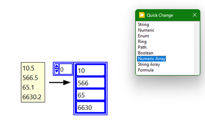

One thing I noticed during testing:
If create list of floating-point numbers, then use quick change to convert to a "Numeric Array", the result is an array of I32 integers rather than an array of doubles. See image below.
I suggest making one of the following changes (or maybe both):
1) Automatically detecting the use of floating-point numeric values and converting to an array of doubles if they are detected. Otherwise default to the I32 Array.
2) Include an additional quick label dialog list entry for a floating-point numeric value array
Keep up the good work!

I didn't see an option to edit my post, so assuming the time limit expired. I have small correction to the picture I posted. (I meant to select "Numeric Array" for the illustration, but unintentionally selected "Numeric" instead, which may have caused some confusion. See below for corrected image.
Thanks!
-Alex W.
I'm happy to report that this will be working correctly in the LabVIEW 2023 Q3 release.

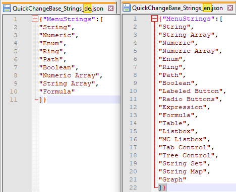

Hello Christina,
It seems there is a bug in german version when selecting an item in Quick Change list.
It seems that the contents in QuickChangeBase_Strings_de.json and QuickChangeBase_Strings_en.json doesn't match.
Copying the contents from english to german *.json file works fine
