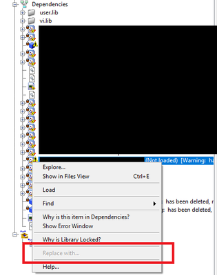

I got some code from a coworker that I'm building into an EXE.  There are a lot of references to user.lib (like 60 classes) and the folder structure that my coworker gave me makes some of the classes in user.lib too long and causes the exe to fail building.
I moved the stuff from user.lib to a root folder on my C drive and now I have to manually update every class because they aren't in user.lib.  Its pretty time consuming and I think just saying "Look in this directory for the missing files" would help tremendously for larger projects that need to get moved around.
When refactoring code, I often find myself in a situation where I've broken dependencies. Maybe it's a name change, or a library path change. This is precisely when I'm most in need of the ability to just replace the missing file (be it a VI, control, class, or PPL).  Yet this is when LabVIEW decides that nope, it can't be that easy:
Instead you have to track down every instance and manually swap them out.
The request: allow us to replace missing files using the "Replace with..." option.
