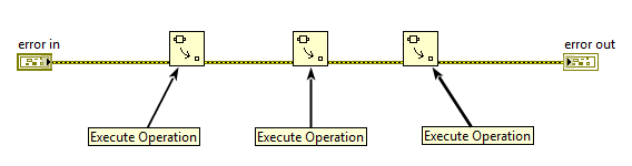

I really like the new arrow feature with block diagram comments.  But in many cases, I have a comment that applies to more than one BD object.  So, I would like the ability to link my comment to multiple objects instead of just one.
This would allow me to turn this:
into this:

JÞB
Knight of NI
use a single frame sequence.  (Now I'll never be let into heaven Smiley Embarassed)

jlokanis
Active Participant
Never!  Smiley Surprised
Actually, that would not solve it because often the related items are spread around a block diagram and not necessarily chained together so neatly like in my example.

Manzolli
Active Participant
@Jeff·Þ·Bohrer> Just use a Flat Frame decoration and you are back on heave's business!

Ljubo
Member
Try this: one big frame with comment and five small rectangles.
