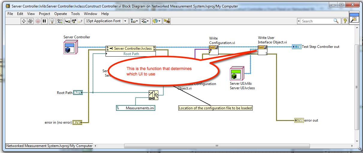

The attached code serves as a reference architecture for the core architecture of large-scale test and measurement systems, especially long-running tests that are commonly associated with the characterization and validation of a physical system.
The Measurement Abstraction Framework demonstrates solutions that address the following common requirements:
  1. Hardware Abstraction Layer(s): The de-coupling of hardware and instrumentation through a class interface that allows tests to be easily reconfigured to utilize different devices or vendors without modifying test code
  2. Measurement Abstraction Layer(s): The ability to change and override the default behavior and display of a measurement based on a class interface without modifying test code
  3. Channel and DUT Abstraction: The ability to map IO for a specific device to sensors or a DUT in a way that can be stored and referenced without specific knowledge of the device in use
  4. Factory patterns for plugins: Dynamic loading of new capabilities and functionality without modifying or even restarting the main framework
  5. Simplified test definition: How to enable the creation of tests by users who are not experts on the framework or advanced programming concepts like OOP
  6. Logging heterogenous data: How to stream data from multiple devices at multiple rates in a way that can easily be correlated and analyzed offline
  7. Storing/aggregating data in a central location: How to upload the data from tests to NI SystemLink for visualization and offline analysis
  8. Asynchronous actors: Usage of Actor Framework for a highly asynchronous system that allows multiple sub-systems to communicate while acting independently
  9. Configuration storage: how to store device and measurement configuration to disk for later reference, as well as how to pass this information to TestStand
  10. Simplification of TestStand: simplify test definition in TestStand through configuration-based workflows that employ custom step types
  11. Reusable across validation or production: the framework is designed to execute the same measurements and devices purely from LabVIEW or they can be sequenced and the channel names can be referenced from TestStand tests
  12. Remote execution of tests on RT targets: How to sequence the execution of tests running on a Linux Real-Time target from a Window Host running TestStand. Note: this functionality was available in previous versions but is not in the 5.3 release yet. It will be re-added after NIWeek

I have a question about error handling in Controller.lvclass.  HandleError.vi is overridden by Controller to call Receive Error From System, which sends a the message Handle System Error to the Error Handler Actor.  The Handle System Error message in turn sends a Log Status message back to the controller with the error info.  I see that the override of Controller:Handle Error has a TRUE constant wired to the stop actor? indicator, which will stop the controller's Actor Core, as I understand it.  How can the Log Status message be processed by the controller, if the controller's Actor Core has stopped?  What am I missing here?
AristosQueue
Proven Zealot
Proven Zealot
on
dirtyray:
Eli has been traveling a lot, and as this is his design, he'll have a more definative answer. I *believe* the answer is as follows:
I believe that the Error Handler Actor is designed to work with any caller, and so it sends messages back to its caller in the even that the caller is still running. In this particular case, the caller has decided to go ahead and exit. That does not negate the utility of the design of Error Handler Actor for other actors.
... but if Eli contradicts me later, accept his answer.
Elijah_K
Active Participant
Active Participant
on
Ah, this is a very good question, and one I admittedly don't have the greatest answer for - in fact, this has given me pause to re-evaluate my error handling strategy in this system.  Stephen's answer on my behalf is accurate, but that doesn't mean this is necessarily as it should be.  The simple answer to your question is, "it can't be processed by the controller!"
Thinking back, I was torn between giving all the actors access to the error handler actor queue, or continuing to insist on decoupling everything, such that only the controller is aware of how to communicate with separate entities.  As it stands, actors are designed to pass any errors to the controller, who then immediately relays them on to the error handling actor.  Most of the actors just shut down if they incur an error, so if the source of the error happens to be the controller, it will shut down and never receive the log message.
If/when I re-approach this aspect of the design, I'm tempted to treat the error actor as a proxy for the controller in the event of an error - perhaps I would even include it in the controller library.  I could give all the other actors in the system the error actor's reference in order to enable direct communication, and then encapsulate the decision making process within the error actor , who could then dispatch 'shutdown' commands via the controller, if necessary.
Not sure though... need to give this more thought...

I think I might of somehow posted a question to the wron forum,, sorry if this is somehow a duplicate,, but here is the situation I have,,
I've read all the documentation I can find about LVOOP and the Actor Framework, this Measurement Utility looks great and I'm ready to "port" one of my simpler projects.
So I use the Project Wizard to build the new project, see that the main UI is the Server UI, I open it up but I can't seem to figure out how to add the old projects UI functionality, I must admit that this new UI architecture is a technique I have never used. So could someone point me to a document or example or whatever so I can get up to speed on this technique??
Thanks in advance.
Elijah_K
Active Participant
Active Participant
on
I'm happy to help, but I'm afraid I don't quite understand the question.  Are you trying to replace the Server's UI with a UI you created for a separate project?  You can do this, you'll need to create a new actor class that is a sibling of the abstract UI class.  This new UI definition will then need to be set as the UI the controller should use in 'Construct Controller.vi.'
If it's totally different, replace 'Measurement UI' with your new UI.  If it's similar to the current Measurement UI you can inherit the functionality it contains (just like the server and client do now) and create a new child of 'Measurement UI'

Elijah_K
Active Participant
Active Participant
on
This illustrates the function that sets the UI.  Note that if you're new the AF, you might be better off starting with one of the current UIs and customizing it.
Also, the Server Controller is coupled to the Server UI.  You'll probably want to create a new child class of 'Controller' and create a new 'UI' definition for that controller.  This is similar to how the Server Controller is coupled to the Server UI and the Client Controller is coupled to the Client UI.

Elijah_K
Active Participant
Active Participant
on
One final point: if you're looking for the actual front panel that appears, open 'Actor Core.vi' in the Server UI class.  If you look at actor core of the parent class ('Measurement UI'), you'll see that it inherits a lof of the UI definition from the parent.
