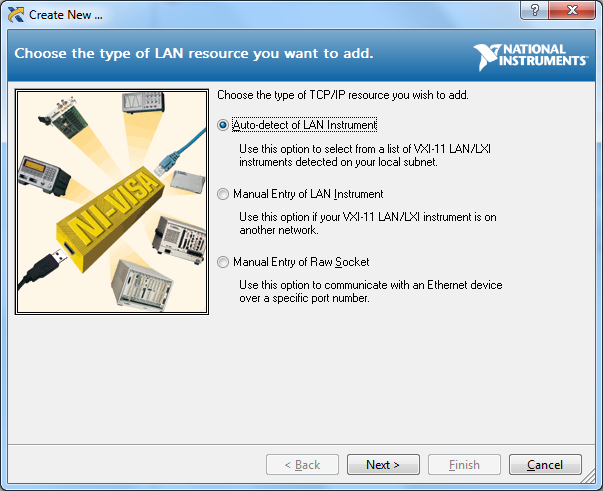

Hi Brain & all,
In terms of auto detect what do you mean?  If I connect the LXI instrument to the PC with proper subnet configuration between PC and instrument, should the MAX automatically list out the instruments under "Devices & Interfaces"?  I am not able to auto detect the LXI instruments this way now.  I'm able to connect to my LXI instruments only when I manually click for "Devices & Interfaces-->Network Devices-->Create New VISA TCP/IP Resource -->Select "Auto Detect of LAN Instruments"?
I'm expecting a way where I need not go to MAX to search for the instruments, but use "VISA Find Resource" to get all connected LXI instruments.  This VISA Find Resource works great with GPIB, even without intervention into MAX, I can get all GPIB instruments connected and I am looking for similar auto detection of the LXI instruments as well.

@Ajay_MV wrote:
Hi Brain & all,
Ajay.
https://forums.ni.com/t5/Instrument-Control-GPIB-Serial/NI-VISA-is-not-detecting-my-LXI-instrument/m...
@Dan_Mondrik wrote:
Note that with the latest version of NI-VISA (4.4) we added this feature:
Added automatic detection of LXI (TCP/IP) devices that support the mDNS and DNS-SD technologies.
This will now auto-discover LXI devices that conform to the latest LXI 1.2 spec.
This means you no longer have to manually go into MAX before using it in NI-VISA.
Dan
