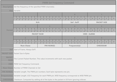

It does not look like the frequency control has been brought out as an input the the VI.  I found this which explains the interworks of the PWM Set Frequency but I am not sure the exact context.  Maybe this is used inside the PWM Set Duty Cycle VI?  I have not looked at this on a system with LINX installed.  https://www.labviewmakerhub.com/doku.php?id=learn:libraries:linx:spec:pwm_set_frequency
What device are you connecting to in which you are using the PWM on?  If is is a Raspberry Pi you may want to check out the LINX Raspberry Pi Addons by MediaMongrels.  It may have the functionality you are looking for.

Hi jorgemondadori (sim, Brasileiro),
I had already done the test with this generator, but it didn't work as expected.
In my application I need to vary the duty cycle (5%, 10%, 25%, 50%, 75%, 100%).
Hi DavidWilt,
In this case, how would I change the frequency by changing the bytes?
Could you prepare a step by step?

Hey, Rodrigo, just had a look at this topic recently.
It sounds like it is a internal AVR timer thing.
https://www.etechnophiles.com/change-frequency-pwm-pins-arduino-uno/
https://anupmarahatta.blogspot.com/2019/05/changing-arduinoatmega328-pwm-frequency.html
When you declare on arduino IDE the pins you can change such configuration. However you won't be able (as far as i understand) to change specifically to 200Hz. I measured the output of a pwm with an oscilloscope, and in fact it is not 500 Hz default, it is 490 Hz. The website i linked explains how to set Timers.
If you don`t need to chang you frequency during execution, you can modify the Linx firmware to set those different frequencies and pins.

Rodrigo, i don't know how to do that since it is not implemented in LINX.
even if we could do that, you probably won't be able to achieve 200Hz, only step associated to timers.
with that in mind, it may be the reason why they did not implemented the library, because could impact on other functions.
