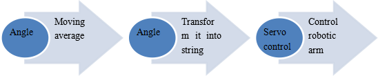

③ analyse and control with labview
Now we describe the structure and procedure of the VI.
First of all, we transmit the data to labview from kinect .
Secondly, we need make sure the mechanical arm can move the specified positon.this is a robotic problem we are naturally recommended to use the robotic tool offered by NI. Here we mainly make use of robotic tool kit to solve inverse kinematic :Calculate the angles of servos in mechanical arm. Whether we need to analyse the angles in gesture track or object capture,we can analyse in the same way: define the bottom of mechanical arm to be the coordinate origin then calculate the relative XYZ coordinates which can be converted into angels via the robotic tool kit.  Meanwhile,we can display the whole procedure in 3D of the mechanical arm in labview.
Thirdly ,to make sure the movement be smooth,we design two modules to realize functions of  moving average and pd feedback.
Fourthly, get the object’s position. Primarily we tell the labview which object is the target by draw a regional in the frame. learned the object’s characteristics,labview could recognize and track it when the object moves away. In the meantime , labview calculates the value of XYZ coordinates of the object which is used in robotic tool subsequently.
At last, to memorize a specific movement we storage the component of the movement, “a series of movements” in other words, into a register( a text book). Once we want the system to perform as a specific movement, the system can move as what is stored in the register , whatever the time it need perform is.
④ control the mechanical arm
Given the angles and the fact that servos are driven by character string with format as #3P%d #4 P%d #5 P%d #13 P%d #14 P%d #15 P%d where the number after”#” stands for the servo number and the “%d” means the width of pwm wave which varies from 500 to 2500 . we use a system of conservation formulas to change angles to character string.
