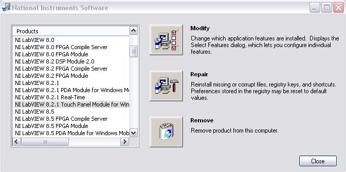

The Touch Panel Module is not appearing under Measurement and Automation Explorer?  That is strange.
If it is not appearing, we need to verify that it was installed.  It will also show up under Add or Remove Programs >> National Instruments Software, and under the NI License Manager under Start >> National Instruments >> NI License Manager:
If it is showing up here, than the installation may not have been registered with LabVIEW or MAX.  In that case, we will need to repair the installation of the Touch Panel Module 8.2.1 (Assuming you are using LabVIEW 8.2.1).  Also keep in mind that, you must have the same version of the module as your version of LabVIEW.  8.2 will install to LabVIEW 8.2, the TPC module 8.2.1 will install support for LabVIEW 8.2.1, 8.5 for 8.5, etc.
The TPC 2006 ships with Active Sync and some drivers from the manufacturer, which will allow you to see the TPC through Active Sync, this does not mean you can target it with LabVIEW.  For this we need the Touch Panel Module.  So I want to make sure that we have the correct version installed.  I hope that this makes sense.
