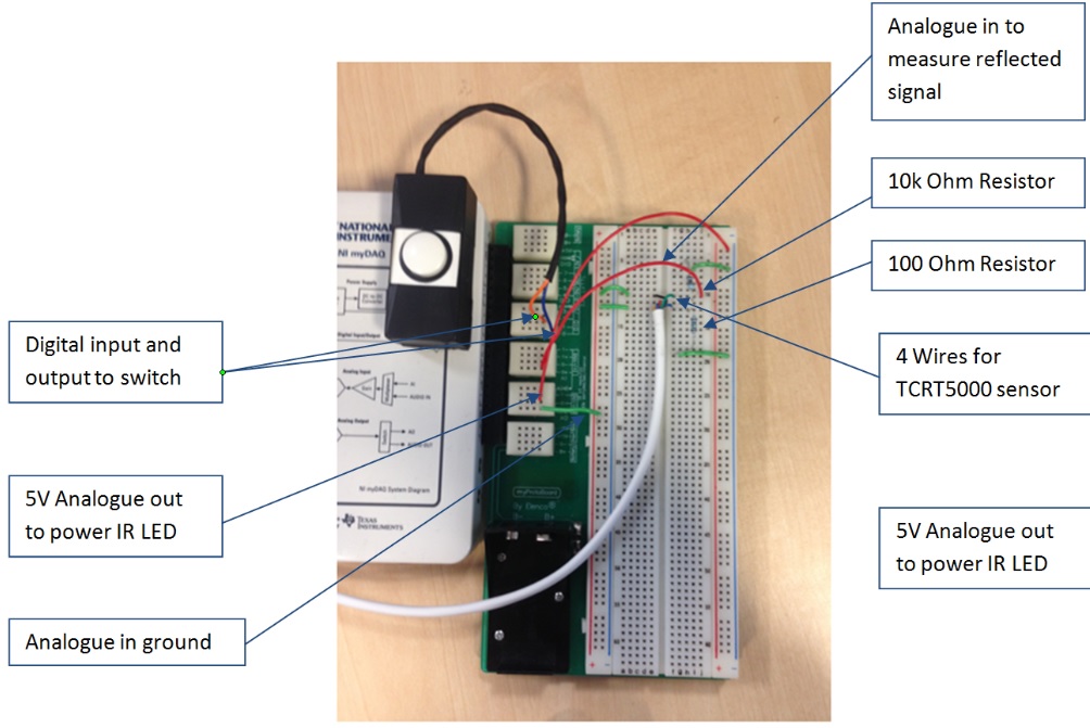

The aim of the project was to build the system for as little money as possible, for that reason, the blink detection hardware simply utilises a single TCRT5000 optical reflectance sensor, a pair of 3D cinema glasses and two resistors. The finger movement detection circuit is a very simple switch that in this case is an upcycled door bell to provide a large and sure surface to press on.
The prototyped circuit for the TCRT5000 sensor is shown below:
Figure 6: Prototype Circuit Layout
Figure 7: The TCRT5000 Sensor on the Glasses
The TCRT5000 is mounted onto the frame of the glasses to hold it steady and utilises the flexibility of the wires to allow positioning specific to the user’s eyes.
The sensor itself works by firing an infra red signal at the white of the user’s eye, it then measures the reflected signal using an infra red photo transistor, and this reflected value varies depending on whether the signal is reflected off of the eye ball or the eye lid. The software analyses the signal to detect whether or not a significant enough change in signal has taken place.

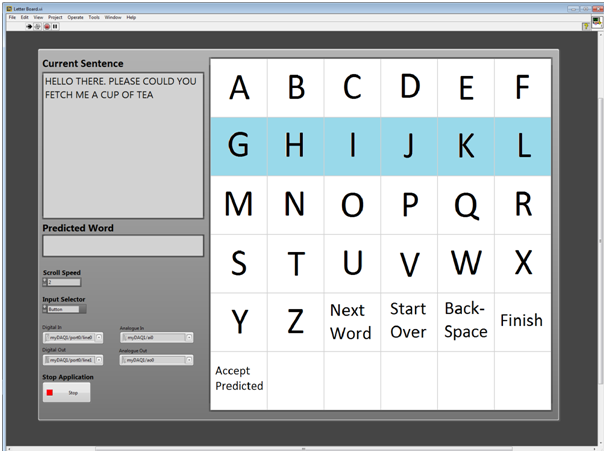

The following is the digital letter board layout, from the image it can be seen that the blue highlighted row/column is the active and selectable section.
As can be seen from the user interface, the digital letter board provides options for editing the written text in case a mistake is made or a change is needed.
Figure 9: The User Interface/Front Panel
The board also has room for expansion should common words wish to be used or new options added.

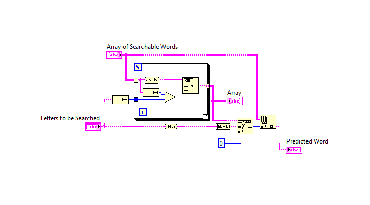

Further to the movement detection and speech systems, included in the software is a predictive text function. The predictive text takes a text file of the 1000 most popular words in the English dictionary and arranges them based on their popularity, based on the letters that have been typed of a word, it will return the most popular word that begins with those letters.
predictivecode.pngFigure 10: Predictive Text Sub VI Code
The overall architecture was simply a state machine where shift registers handle the increments of the scrolling and also the passing of the strings of text for the speech system.
