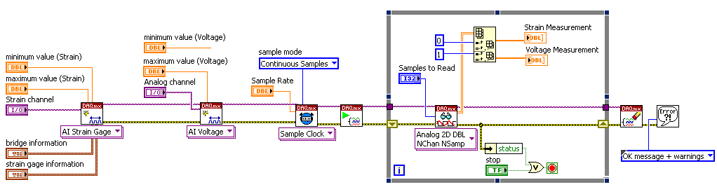

This example shows how to synchronize strain and voltage measurements using a cDAQ chassis.
Description
You can easily synchronize your strain and voltage measurements using a cDAQ chassis.

    1.Choose a channel for the strain gage measurement
    2.Choose a channel for the voltage measurement
    3.Set a Sample Rate
    4.Set the number of Samples to Read
    5.Run the VI.
