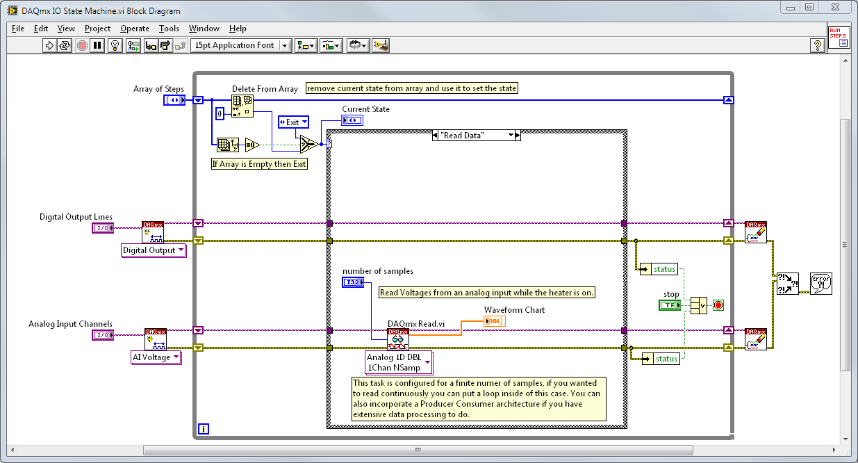

This VI shows how to use a State Machine with an array of steps to run throguh a pre configured list of steps.
Description
This Example shows a process where we turn a heater on, then measure a finite numer of samples then tunr the heater off.

  1. Set the Physical Channels for a digital output and analog input.
  2. Configure the Steps from a list of States dropdown.(to add new states right-click the dropdown and select Open Type Def and Edit the Elements)
  3. Set the Numer of Samples thenrun the VI
