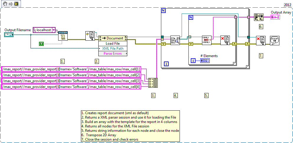

This code allows the user to export a MAX configuration report from LabVIEW.
Description
This example shows how to programmatically export a MAX configuration report from LabVIEW, then parse the XML file. It uses Generate MAX Report.vi and XML Parser API VIs to access to the MAX Report information.
