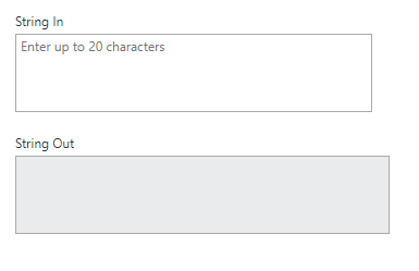

The above changes the behavior of the NI String Control to use a placeholder text and be restricted to a maxlength (Reminder: manipulating the behavior of NI controls is not supported, see warning at start of page):
