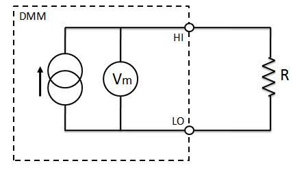

Connection Diagram
257110i36FB78973B7D856D
Background
A resistance measurement consists of two main parts:  1) sourcing a constant current across a load and 2) measuring the developed voltage.
Once the measured voltage is known, Ohm’s law is used to calculate resistance:

The code consists of the following steps:
  1. Initialize a session to the device.
  2. Set the function of the device to be constant current.  This will allow the device to output a specified current value at any voltage.
  3. Change current limit from default of 100 mA to 20 mA.  Then set the current limit range to 20 mA.  The PXI-4110 has both a 1 A current range and a 20 mA current range; the 20 mA current range is used here to maximize precision.  The PXI-4130 has several current ranges available, 20 mA was chosen to simplify the example
  4. Configure the voltage limit.
  5. Configure the current limit.
  6. Enable the channel.
  7. Measure the voltage.
  8. Measure the current.
  9. Calculate the resistance: R = V/I.
  10. Disable the channel.
  11. Close the session to the device.
