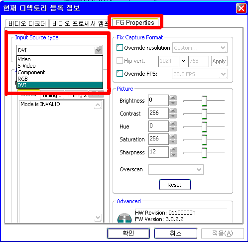

I'm using Image Capture board called "UFG-07 HS"
I wanna switching to "Input Source Type" on LabVIEW VI(ex. Click the boolean)
Can I do it?
Then, Please Tell me the solution and advice.
Thanks.

Probably,
Can you open this property page from LabVIEW? (DirectShow - Pin Property Page.vi)
If yes, I assume some parameters can be passed programmatically, if driver developer didn't expose them, you still should be able to change parameters with windows API tools.
-Artur
daniel0803
Member
Member
on
I Can open Pin property page.
But I don't know how to change parameters(Input Source Type).
I'm beginner developer, so I can't understand your answer well.
Please show me the LabVIEW example(on Blockdiagram).
Thanks.

I have a Conexant CX25858 decoder card, but is not on my development PC. I'm not allowed to get the microsoft SDK on this pc and I'm not experienced enough with the directshow developedment to see the direct problem.
The problem I currently have is a black screen on this conexant CX25858, but the software work on my development PC with my webcam. The only difference I see is the signal of my webcam is RBG24 and the signal from the CX25858 is YUY2. Another reason could be not correctly installed codecs on the PC with the CX25858.
Cheers,

Add "color space" filter which convert yuy2 to rgb.

I currently have it working in Graphedit (I managed to convince people to install MS SDK on the PC with CX25858). But I have no clue how to add the Crossbar into Labview. Is there an example or maybe somebody who could give instructions?
