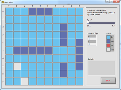

The Challenge - Classic Battleships!
Download the attached Battleships simulation game, open Battleships_Main.vi and run it. Recognise it? Great! Open the block diagram and locate “Your VI Here” - this is the smart bit that decides where to fire the salvos. The challenge is to create your own solution for solving the grid in as few a moves as possible! The included “Your VI Here” uses random coordinates, which isn’t smart, so replace the block diagram with the best solution you can!
During the DutLUG we’ll pitch all your submissions against each other, to determine who can sink all ships with the least amount of shots. The winner will receive the giftcard prize!

Nice competition, maybe I'll give it a try but I wonder what the game rules are before starting? Because I remember that normally a player is told when a complete ship is sunk. So when you hit both coordinates of the smallest ship (2 blocks), you can eliminate all surroundings of this ship since you get feedback that you sunk a complete ship. Are you allowed to use this feedback? Because if it is allowed, you do need to check some stuff in the host map 😉
And from the code I can tell that collisions in any directions (horizontal vertical and diagonal) are not allowed, but it's good to mention this in the game rules.

Hi @Brandts
Thank you for your question.
The game will not give you feedback that a ship was sunk, it only returns if the square you shot at was a hit or a miss. Your algorithm needs to figure out if a ship was sunk by itself. Smiley Wink
