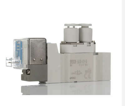

Hi everyone,
While testing application with NI - 6512 DO card, Diver IC A2982SLWT for first Bank(P0) got damaged(Burned). So after that i had checked wiring but i didn't found anything wrong with the wiring.
I have attached file for understanding exact problem.
Please have a look and hope for instant reply.

Hello, i have the same problem. Do you know what is the root cause of burned ic?

what is connected to the DO? and how exactly are those powered?

Outputs are selenoid valves. I guess powered by NI6512. I checked all wiring there is no short or something.
Do you use a freewheeling diode to avoid damage from back emf?

there are flyback diodes on the coil of these valves. I checked them no problem. Maybe there was short somewhere, somehow happened. But it did not happen again. Thank you for your help.
