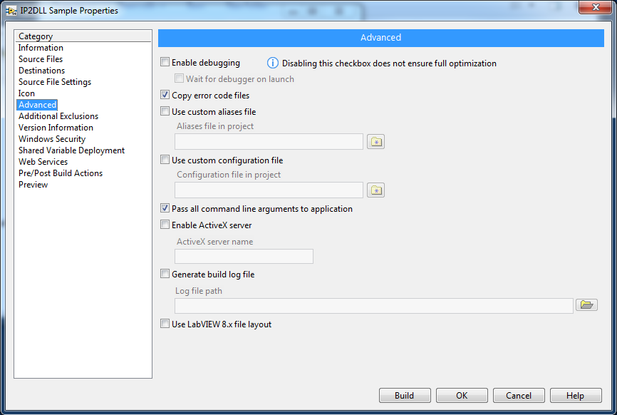

To correctly initialize the license files (to avoid permission issues on Windows Vista or later) follow the next steps:
Below the Build Specifications of your project, right-click your executable and click Properties. Click on "Advanced" and check the "Pass all command line arguments to application" check box. This will help your application correctly respond to the /OPENLF flag described in step 4.
Advanced settings
Once you have configured all of your build specifications, click Build. When your executable runs, it will check the Instant Protection PLUS 3 license first. Upon validation, it will pass the execution control to the main VI of your project. When testing your application, be sure to copy your XML file into your executable's build directory. To find your executable's directory, right-click your executable and click Explore.
