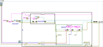

I have a problem with my TDMS files. I have stored data in TDMS for the last week with a new file beeing created every hour to avoid data loss in case of a crash etc. I've used LabVIEW 2009 and the storage procedure is shown in the attached snippet.
Storage
The problem is that some of my files are corrupt. When i try to open them in DIAdem or LV i get Error 2511 saying that the file could not be opened since it is corrupt. I have looked around on the forum and found that people who have the same problem have had different versions of TDMS but I use LV 2009 and DIAdem 11.1 so TDMS 2.0 should be supported. Also, some of the files are perfectly ok, it is only about one in three that is corrupted.
The broken files are the same size as the ones that work, so I know that there is data inside them, and I am desperate to get that data out. Is there any way to do this?
Does anyone know what the software problem might be, and why some of the files are broken while others aren't?

A larger picture. The previous one turned out a bit small.

Hi Felix,
Why do you create the first TDMS file on your 😧 drive and then create all subsequent TDMS files on your E: drive?  For those files that you can't load, please try deleting the associated *.tdms_index file and then try reloading that TDMS file.  The *.tdms_index file will be recreated when you try to reload the data file.  If the problem is in the index file and not the data file, that should quickly fix everything.  If that doesn't work, please post one of the problem TDMS files or email it to me at brad.turpin@ni.com.
