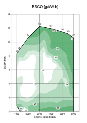

I want to express the same graph as the picture.
A detailed explanation is needed.
Can the maximum and minimum values be displayed among the displayed numbers?

The physical quantities graphed on the Y and Z axes are different, and the Z axis coloring is polychromatic instead of monochromatic, but otherwise your graph looks virtually identical to this shipping example in DIAdem:
"Characteristic Diagram Display"
The example loads a series of sheets to the REPORT panel that shows you many different display options for the characteristic diagram display object-- I recommend you look at "Sheet 4" which has the global maximum and global minimum values displayed prominently.

Where can I possibly see the example report?

You find this example by opening the DIAdem HELP menu, selecting EXAMPLES, and clicking on EXAPMLES GALERY. If you then scroll down, you find the picture.
By clicking on the picture, you start the example. If you keep the CTRL key pressed and click on the picture you get the description for the example as well as the used files (which can be loaded then).
