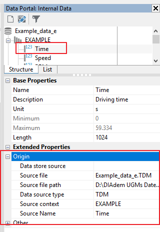

Hi Nilfheim,
If you are looking for file name or file path, please have a look at the channel properties:
If you drag & drop a property into the script editor you get the syntax.
Greetings
Walter
