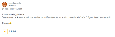

@Dzamudio
Did you ever found out how to subscribe for notifications for a certain characteristic?

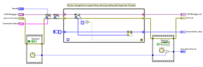

More than 22 bytes can be read using "Read long" command. This is supported by the driver, message ID is 0x08 (instead of 0x04):
Then cycle serial read until received data size is below 22:
Here are modified vi's if interested: https://drive.google.com/file/d/1TI2hrPDVpciMO7tJ9CVEhvzHnfogAvo7/view?usp=sharing

Solution for notification !
To activate the notification, you must write 0x01 to the following address of the address on which you want to receive the information.
For me (native UART with Nordic BLE) :
I need to read in the Handle 0x000F
I have to write 0x0001 in this handle first.
Note : For me Read by service/UUID works fine but writing by UUID at this address  "2902" don't. That's why I write by handle.
I hope it helps!
