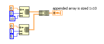

Another one: Empty arrays (>=2D) have "ghost" non-empty dimensions that affects operations with other arrays:
On concatenation, the appended array takes the largest number of columns, which is 10 even if the first aray is empty.
It may be handy when initializing an empty array that must have a minimum column width.
