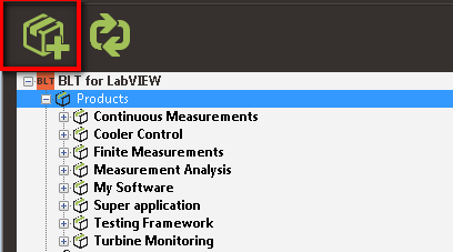

  • Open BLT for LabVIEW, select the "Products" category and click on "Add a Product"
    http://help.studiobods.com/bltforlabview/lib/Add%20Product%201.png

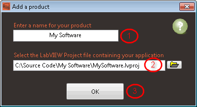

  • Enter a friendly name to identify your product in BLT, and select the path of your existing LabVIEW Project. Click "OK" to add the product in BLT
    http://help.studiobods.com/bltforlabview/lib/Add%20Product%202.png

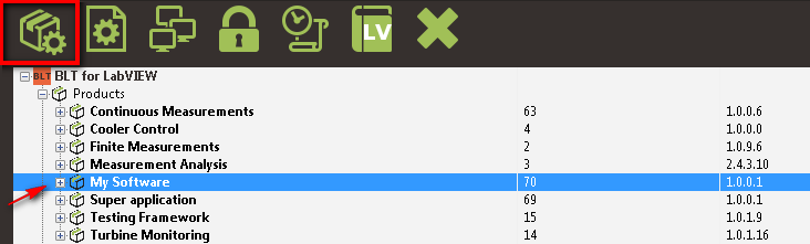

  • Your LabVIEW program will now appear in the list under the "Products" category. Select your product in the list and click on "Configure Product attributes"
    http://help.studiobods.com/bltforlabview/lib/Add%20Product%203.png

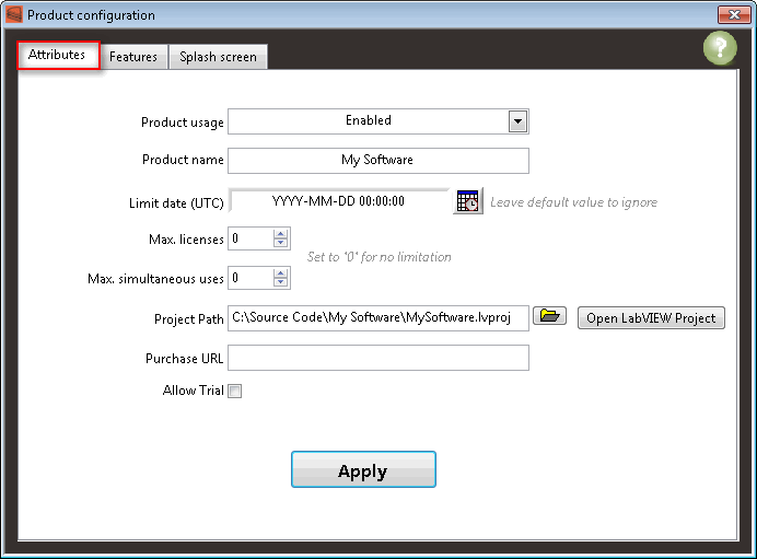

  • On the window, you can access the configuration of your product attributes, and define some Product Features that you can enable or disable for a specific user. You can also design a splashcreen for your application so it looks more professionnal when you distribute it to your customers.
    http://help.studiobods.com/bltforlabview/lib/Product%20Attributes.png
