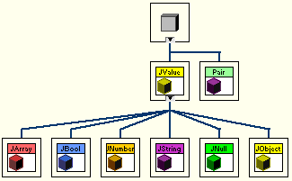

During Beta-Testing of LV 2012 I also wrote a small LV<->JSON serializer that also did nice with UTF encoded+encoding strings. I used an intermediate reprensentation of the data in terms of recursive LV Objects (for any supported JSON datatype - fortunately only 6 - I had a class derived from a generic "Value" class; Array and Object would store an array of "Value"s - with/without labels)
In addition, I managed to write a very cool feature to "LabVIEW-script-create" clusters from a JSON description, however this renderer is working only in the development environment (but could be worth a nice QD plugin ).
Basically, JValue knows 2 parser and 2 renderer, so it's possible to read/write JSON text and read/write LV clusters. I never planned it to extend to XML (I would need to create all the datatypes and write the parser/renderer for each) but there's already a toolkit for that .
If you're (still) interested in my version, I'd be happy to post it to a proper location in the NI community.
