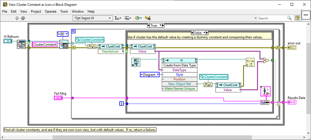

This test returns a failure for any cluster constant with a default data type value, that is not set to "View Cluster As Icon":
If a cluster constant has the default value for its data type, it should be set to "View Cluster As Icon" to save on block diagram space.
