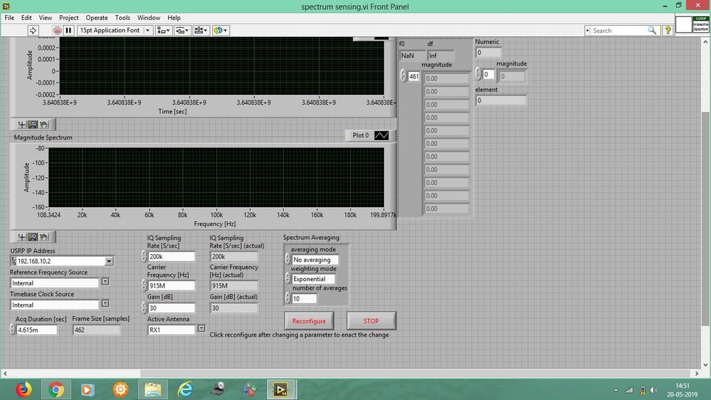

Here are my VI program,
block diagramblock diagramfront panelfront panel
regards,
John

problem in syncing data with 4.615msproblem in syncing data with 4.615mshello Sir in above code can we collect 1000 sample in 4.615ms  i am not able to sync my execution timing with usrp2920 execution code
eg.
in 4.615ms i want to take 1000 samples
so in 1s=1000/4.615m samples=216684
in 1minute=2166848*60= 130010083
i am saving tdms file within while loop but it is just giving around 60000000(almost less than half samples) why this is happening sir.....
problem in syncproblem in sync
