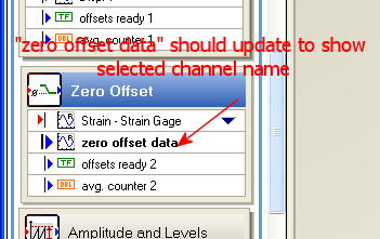

I'm not sure how much control R&D has with the way signals are passed from one step to the other but I have a few issues that have been driving me crazy lately, especially with the new Zero Offset step.

  • Zero Offset Step window clean-up suggestions
    When selecting a channel to zero, "zero offset data" should update to show the currently selected channel type. As of now I have to manually rename this zero data signal.
Furthermore, does the "offsets ready 2" and "avg. counter 2" need to be in there? Seems cluttered.
