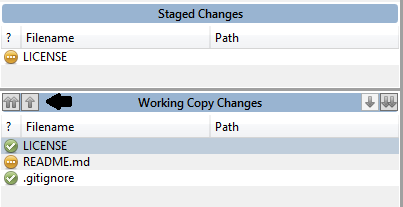

When it comes to committing, git is also a bit strange. It is even more strange than Mercurial, the other big DVCS. Basically, in order to commit changes you first have to add them to the index. From the command line, follow the basic guide. For SourceTree, the visual nature really helps here:
The bottom half of the image is everything going on in your working copy. It shows new things, unversioned things, modified things, etc., with filters for each type. The top half of the image is the set of files staged to be comitted. You can stage changes and keep working, or you can stage changes and immediately commit those changes. To stage changes, just press the up arrow (being pointed at in the image). To unstage changes, press the down arrow. Simple. Kind of.
To commit these changes from the command line, you'll still want to follow the guide. Sourcetree is easy to handle -- just press the commit button and add your notes. If you forgot to stage a few changes before you pressed the button, you can still stage them from this window without hassle. Its a much simpler experience.
