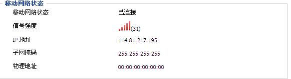

Hi Chirs,
Have you realized the remote device access via Remote Router?
I have a similar application as yours.
Now my network settings is as follow:
cRIO:
192.168.8.7
255.255.255.0
192.168.8.1
Remote Router Local:
192.168.8.1
Remote Router Mobile Modem:
NAT Settings in my Remote Router:
Now the 3G mobile network is proved to be OK, with a dynamic IP address every time booting up the router (114.81.217.195 e.g.).
But when I try to connect the cRIO as a Remote Device in MAX, with the remote IP 114.81.217.195,  an error pops up "Unable to initialize connection to Remote Systems".
And I use a LabVIEW TCP_Simple Data Server.vi and TCP_Simple Data Client.vi to test the NAT, in which I use 114.81.217.195 as the server address, the TCP_Simple Data Server.vi runs on cRIO with
local IP 192.168.8.7, as I think: 114.81.217.195 NAT to 192.168.8.7, but actually it doesn't work.
Do i need to have a static mobile modem IP address? I notice that every time I power off and reboot the router, the mobile modem would be assigned a different dynamic IP address.

Hi Chirs, thanks for your reply.
I have tried many ports including the ports listed above, the program blocks on the TCP Open Connection.vi and then timeout.
Mentioning about the VPN connection, I know for a router which supports VPN, there are two kind of meanings:
some kind of router support VPN Server built in it, such as Cisco 2821,
and some other kinds of router only support VPN Pass Through, which means you could not build a VPN Server in it, you can only visit some other VPN Server by it.
My router only supports VPN Pass Through, what about your router?
Is it possible to realize what we want with the VPN Pass Through 3G Router?
Thanks a lot!
Frankey
Message 9 of 14
(16,268 Views)
For the Simple TCP Server/Client VI, the only port you need to allow is the one listed on the front panel. If that is not working, there is some other problem. It sounds like you have the server set up correctly; maybe there is a problem with the client machine. Could it be that its outbound traffic is blocked? I am assuming you can get to the internet from the machine. Why don't you set the simple TCP server to respond to requests from Port 80, and then try to connect to it from your machine. If that works, that implies that there is something blocking your outbound traffic on other ports.
