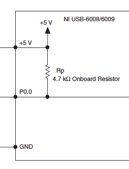

I've been having problems reading from my USB 6008 digital input this morning. Everything was working fine last night. Now all the digital lines on the device read a signal whether there is anything wired to them or not. When I run the DAQ Assistant and test the line, it shows a signal in every line. Then I made the attached VI (which should do the same thing) and it shows a constant signal in every line also. And I have nothing wired to the device. Does it need reset somehow or is it broken? Or am I just missing something?

Look at pages 21 and 22 of the Ni USB-6008/6009 User Guide and Specifications. The digital lines have a 4.7 kilohm pull up resistor to +5 V. That will make an opne input line look (and be) high.

Thanks for the reply. Afraid I'm still a little confused though. If I plug the two lines of my rotary encoder in (for example), one should show as high and one should show as low. I tested the voltage in the lines and they are correct (reading ~0.01V and ~3.9V). But my DAQ still reads as both lines being high. How would my device know if the line is 'open' or not? When I define my input line for the digital signal is that supposed to 'close' the line?
I'm sure I have the correct lines specified in my program, but I still get all lines reading as high.
Thanks for your help on this.
11-18-2012 03:22 PM
I should know by now that when odd things start happening, start by checking the ground. Thanks for your response and sorry to waste your time...
