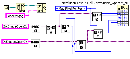

Hello all!
I'd like to know how can I use some code I wrote in C/C++, using the OpenCV libraries, in LabVIEW.
Do I have to create a .DLL and load it in LabVIEW? If so, how does LabVIEW handles the different data types, pointers, etc.?
The script nodes (which I'm not very familiar with) of LabVIEW run C code?
Any help would be greatly appreciated.
Thanks in advance!

Its not extremely complicated. All what you needed is to calling OpenCV functions. Theoretically you can call these functions directly from LabVIEW, but then you should figure out how to transfer structures from call to call. I prefer usually to create DLL wrapper, which will be called from LabVIEW, and inside of the wrapper you have to place OpenCV calls.
For example how to use Convolution (5x5 fixed kernel - gradient) from OpenCV:
We need to call cvFilter2D in this case.
I will create following code:
In the code above we will send to DLL the pointers of the Src/Dst, LineWidth of each image and Width/Height.
This DLL will be called from LabVIEW like this:
In the attachment you can found complete source code of the example.
Andrey

Re: Using OpenCV library in LabVIEW
Excelent answer Andrey, thank you very much.
I haven't tested it yet... Just one clarification, the code you wrote should then be created in a .dll, that will then be called in LabVIEW, right?
Exactly. This is call by following chain: LabVIEW>Convolution Test.DLL.dll>CV100.dll (cvFilter2D)
